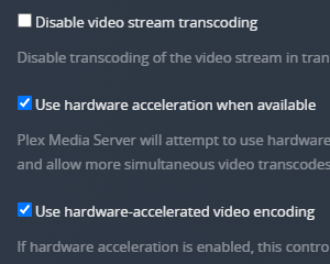

Make sure you have hardware acceleration enabled on your system (Settings → Transocoder).

If enabled, disable HDR Tonemapping in Settings → Transcoder.

Enable HDR Transcoding in Settings → Transcoder

Thanks, this was a great exercise to do, gave me some useful info, and also seems things started working much better once I had setting turned of and back o1 time…
Now its using HW, and its much better :o)
