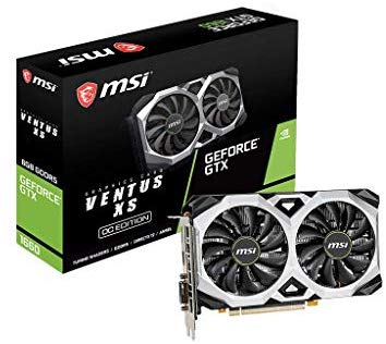

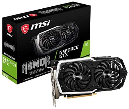

Thank you very much for the reply. What card would be the best out of those amazon links listed below?
cheers
I hope this link might help to buy a right GPU for your Plex transcoding :+1:
