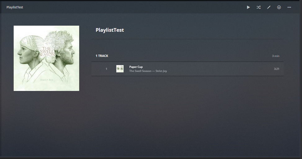

I tried the POST method, but for some reason it only picks up the first file in the playlist. Still investigating.
@nosaj72 ~ let me know, it’s possible there’s a bug, clearly…
Never could get it to take more than one entry. Tried short playlists (i.e. 3 entries), different encodings, file urls, anything I could think of. Most things came back with an internal server error.
If I tried a 2 item playlist, and the first item pointed to a non existent file, I would get the server error. If the first item was correct and the second item was a non existent file, I would not get an error. My conclusion is that it isn’t looking at anything past the first entry.
I’ll pass along to the dev, @nosaj72 ~ any chance we could get a sample playlist?
Here is the playlist.
This is the result:
I’m running server Version 1.13.0.5003 on Windows 10 professional.
