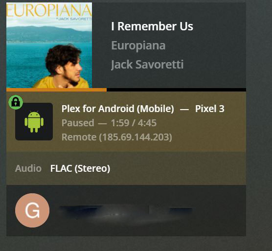

Can you double-check the now-playing tile for such a remote stream from the server dashboard? Is the playback displayed as remote or indirect?
Exemplary screenshot from the "now playing" section
An indirect/relayed connection will only provide a limited bandwidth that might not be sufficient for your video playback (though in that case you should see a different error message). Usually this is linked to a bad remote access setup.
Hi Tom, when playing audio remotely I don’t get direct play or otherwise just the file format (see attached). I can’t play videos remotely but when playing from my own net work I get directplay (see attached also) Is this any help in solving my problem?
