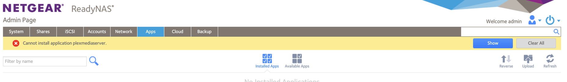

Cannot Install Plex Server Update 1.25 on Netgear ReadyNAS 516
Server Version#:1.25 : plexmediaserver_1.25.0.5220-de6e61df7_amd64.deb
Takes a restart of the NAS to even initiate the upload, then after a few minutes get the error ‘Application plexmediaserver cannot be installed.’
If I attempt another upload after that, get the error immediately. The previous working version was deleted during the installation.
The version 1.11 that is in the Available apps (the ReadyNAS’s ‘App Store’) does install but is completely useless as it very old (the player requires 1.18 and later - BTW, why is it even there?!)

UPDATE 2: Updated Netgear firmware to the latest 6.10.6. Now NONE of the versions (latest three) install. HELP!
Start-Date: 2021-11-22 23:28:10
Commandline: apt-get -yq install --reinstall --allow-downgrades -o APT::Status-Fd=5 /tmp/plexmediaserver_1.25.0.5246-cb2507e4d_amd64.deb
Install: plexmediaserver:amd64 (1.25.0.5246-cb2507e4d)
Error: Sub-process /usr/bin/dpkg returned an error code (1)
End-Date: 2021-11-22 23:28:11
Tried installing on my second backup NAS - same problem. plexmediaserver_1.25.0.5246-cb2507e4d_amd64.deb gives an immediate error,
Attempting to install the version I ever had any luck with (see above) plexmediaserver_1.24.5.5173-8dcc73a59_amd64.deb restarts the web interface requiring a new login, with the plexmediaserver app NOT installed.
It is pretty clear now that the installation has failed on TWO separate NAS’es that the problem is with plex, not ReadyNAS. Anyone?
