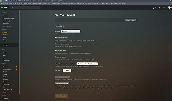

Hi, as title says, I can’t claim a server, when accessing it via hostname. If I access it via ip/port it works ok. I’m running it in docker and I’ve setup a reverse proxy (traefik) to access all my services. I don’t even see server in left panel. When I claim it via IP it works ok, however I can’t seem to turn on remote access (I have public IP with port forwarding set up). Logs said something about “Request came in with unrecognized domain” so I tried to remove server and reclaim it again with this host, but got stuck on this. Attached are screenshots how it looks, when I access PMS via hostname VS IP:
Also regarding my primary issue, I tried to turn on remote access, while on IP, but it also didn’t work. I’ve attached logs (File removed)
