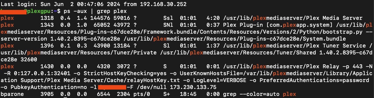

supplemental,
being in the LXC, if you stop plex, given the LXC runs as ‘root’ user inside,
you can use my claim script if you wish.
