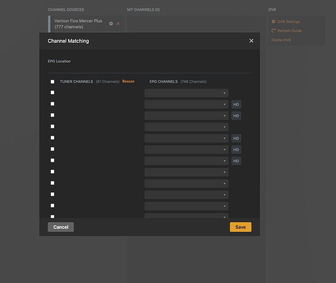

Over the last few weeks, my tuner channels have been unmapping every few hours. I have to delete and create the DVR constantly. This has been happening with XMLTV and Plex’s EPG. I’ve used the most recent stable and public beta builds and I have downgraded to previous builds, but I cannot fix this issue. I am on MacOS 26. Any help would be greatly appreciated!
Follow-Up:
This seems to happen when Plex refreshes the guide data. I unchecked “Perform refresh of program guide data” in DVR Settings and the channels remained mapped until the forced refresh overnight.
