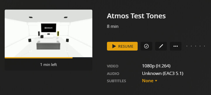

And to make things even more confusing…
The AVR doesnt recognise this file as Atmos when played through Plex. But it does play the 5.1.2 channels correctly. (When playing the noise from above, only the upward firing front and rear speakers fire).
