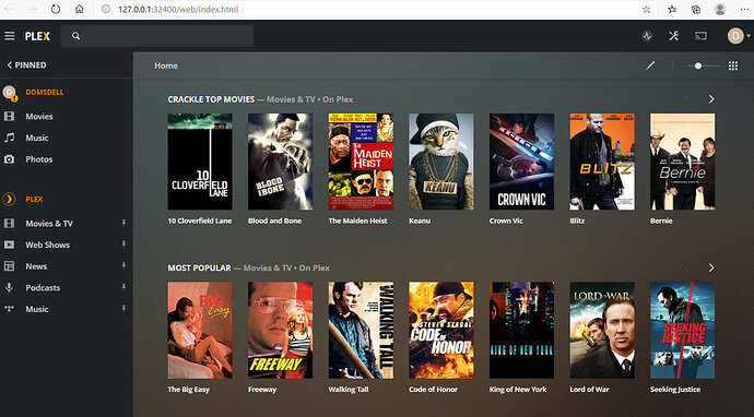

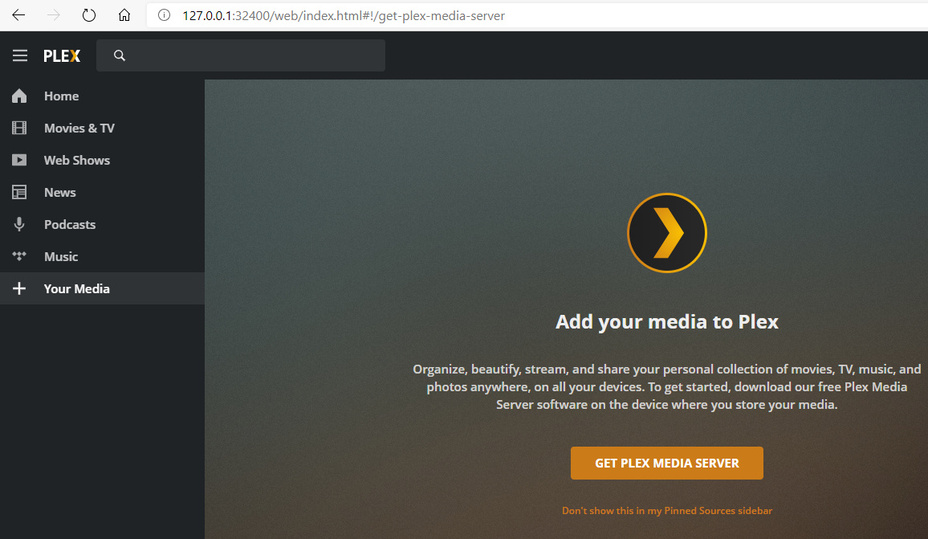

Just wanted to show you what it looks like after I deauthorize the server by doing this:
On the server itself, going to http://127.0.0.1:32400/web/index.html I now see:
And have somewhat of normal options:
All the other web links you gave me for the web player result in not seeing the server though.
