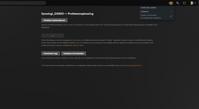

my plex server keeps getting stuck at bundle cleanup at 75%
it is cleaning 154 bundles but wil stay at 75% for days
the only way to get out of this is restarting the PMS
but when the clean starts again manual or thru tasks the cleanup gets stuck again.
before the media scanner was getting stuck at some media files, the reason for that was that some video files where recognised as encv and some audio as enca
i replaced the video and audio files with h.264 mkv and the scanner was working again
but now as mentioned the bundle cleanup is giving problems.
anyone any idea how to solve this

it is not the browser, when i refresh it is stil stuck at 75%.
when i shutdown my computer en turn it on 2 days later it is still at 75%
the only way to get rid of this at the moment is to restart PMS and than it is only gone untill it starts the cleanup again.
