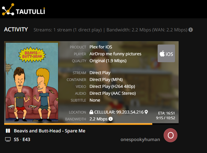

EXAMPLE: Here is a video I’ll try to remote stream:
plex:
tautulli:
Here is a video of what happens when I try. Note the constant stopping and starting for buffering.
I know plex is supposed to have data valleys, but it shouldn’t be THIS bad, should it??
