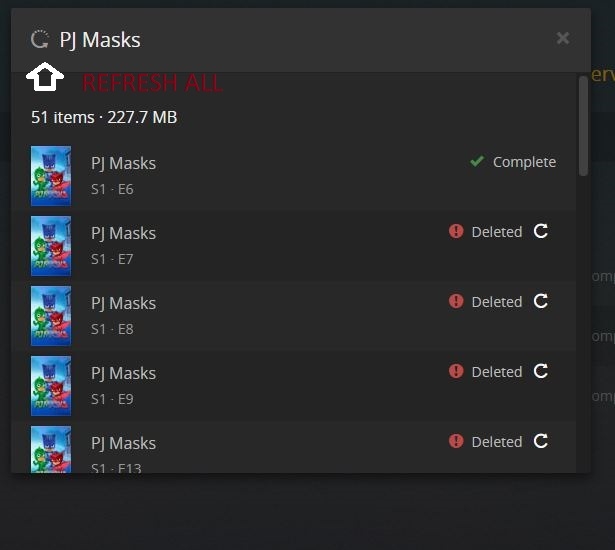

The problem is that the Optimized versions doesn’t pick up new content as I add it to the library, in fact it seems to delete content.
the status looks good
But if I drill down I see a bunch of issues. Now I can refresh that content 1 file at a time.
Which is tedious and impractical.

There is another ask though. Whatever the reason a file got deleted, could we have a “refresh all” button.
that would be awesome :slight_smile:
