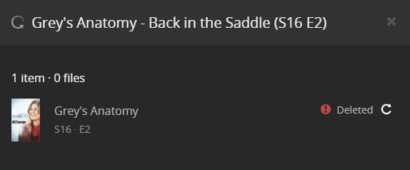

Here is an example. This file was replaced on my filesystem (such as a 720p file being deleted and a 1080p file being added). Plex automatically realized this and remapped the episode to the new file and removed the unavailable file link. The optimized version remains in a deleted state as shown.
If we manually press the retry icon there plex will reoptimize with the now replaced file.
What we would prefer and expect to happen is that when the plex library scanner sees that a file has been replaced and updates accordingly it would send a trigger to have the optimizer to run again on that file. Alternatively when the optimizer sees a source file is deleted it could check if another file exists for the same episode and re-optimize based on that file.
