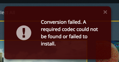

+1 more. Just updated my FreeNAS Plex plugin and now I am unable to play anything.
Everything worked great before the update.
I also have Roku, but this screenshot was taken directly from the Plex webapp.
