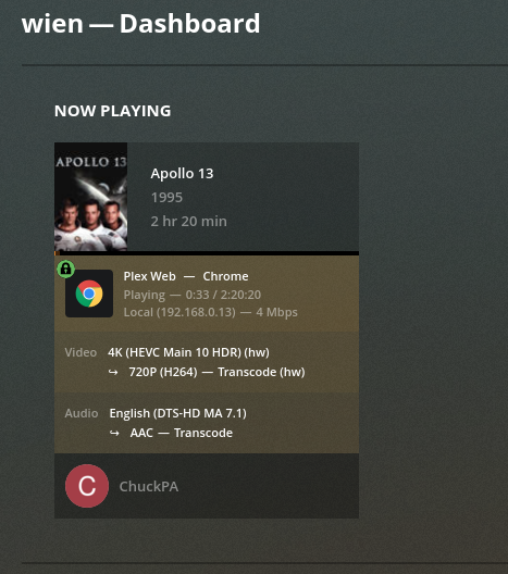

This isn’t a quality issue though. The transcode doesn’t work at all to the web client. The transcode works when the client is my phone or my Nvidia Shield though. Why would it be different for the web client?
The encode that’s being attempted in my case is supported here: https://developer.nvidia.com/video-encode-decode-gpu-support-matrix
There are anecdotal reports from other Nvidia card users for transcodes like this working. I don’t think this is a simple incompatibility.

where are you running PMP? Windows?
Which browser?
I ask because I’m running now, in Chrome, at 1.5 Mbps 720p → 4 Mbps 720p without issue of any kind.
Given you have no difficulty with your devices, what is it about the computer (browser and PMP client on that computer, aka Windows, which you have running .. firewall / browser extensions?
I will be candid here. P400 ? It’s a 30 watt, low power, small memory, low end GPU.
https://technical.city/en/video/Quadro-P2000-vs-Quadro-P400
Which is it? The target machine (Windows) or the GPU?.
Do you have quality problems when you turn off the hardware and let the CPU crunch through it? (stuttering notwithstanding)
