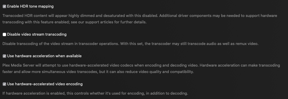

So I’ve been busy the last month, so only the wife has been using the Plex.
Now I’m back and wanted to see some of my movies. But none of my 4k HDR files will all the sudden not play.
Transcodes from 4K HDR10 (HEVC Main 10 to → 4K (H264).
Tried with no subtitles and AAC sound to make sure sound is direct played.
TV: S95B, but it’s the same on my LG C2.
I got the logs ready. anywhere special I need to upload them?
Server Version#: 1.31.2.6810
Player Version#: 5.57.2 (platform 6.5)
Could really use some help to troubleshoot this.
Just seems so weird it goes from working just fine to not working at all.
@ChuckPa Saw you helping out others. Maybe could have time to help me out?
Edit: new logs further down

Check Settings → [Server Name] → Transcoding. How are these settings configured on your system?
They should generally be configured as shown. However, you may want to check with “Enable HDR tone mapping” unchecked to see if that makes difference. The software-based tone mapping can’t be avoided if this is enabled, as you’re using Windows on Intel.
@pshanew @JaysPlex
Yes it’s a rocket late processor.
Tried both things without success.
