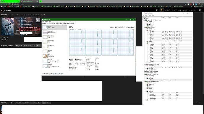

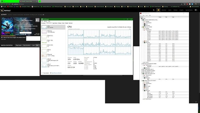

so the issue is some movies use 100% cpu utilization and others don’t , some going for software transcoding and others hw. I want to use HW transcoding to be able to stream or direct play few videos at the same time
first picture the hw transcoding works perfectly but second movie it uses software right?
its the same format if am not mistake
and here i changed the audio i thought maybe its choking on single core audio transcoding
and the speed is 28 but its buffering forever and never play

from your pictures I don’t see why it would transcode hw for one movie and not the others.
you can see the HW indicators on the first one for decode 4k > encode 1080, but not on the other 2.
you probably need to monitor your logs and perhaps that will provide a clue why HA appears to fail.
