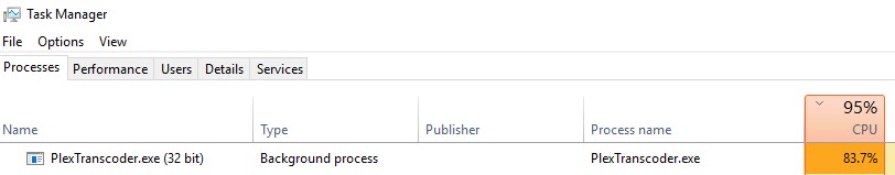

And I don’t understand why the CPU would ever hit 100% during the transcode.

CPU utilization…
well the speed always varies, due the potential number of transcode threads they could end at different times and plex could start a different number of threads at different times.

Not doing any tests on the server itself. Makes sense about the audio but wouldn’t have expected it to tax the CPU to the point where it maxes frequently enough.
