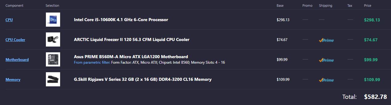

My old PC, Windows 10 plex server died after 7+ long years of service… and I think it’s just the MOBO (have upgraded drives over the years). I intend to start by replacing mobo/cpu/cooler/ram, and I wanted to ensure that I get a “good” plex server machine. Not top of the line, but decent performance. I don’t worry too much about 4k yet (but I’d like to as it becomes easier). I’m not cutting edge at all, I recognize that, so just looking for any obvious input and/or any mistakes I may be missing.
Reviewing the forum posts, seems like I’m better off with Intel. The i5 seems to be a good middle-ground, although I’m not sure if it’s better to get the 10600K (with built-in GPU). I do have an old Nvidia 1GB card which I think still works well, and I don’t mind replacing it when the time comes if that’ll get me better performance.
In other words, should I get the 10600K or another i5 without graphics? Is there advantage to having the integrated Intel graphics in addition to a GPU? I seem to think so, but moving quickly I may have overlooked some things.
Here’s the basic hardware list I have planned currently, again appreciate any input/correction/guidance. Thank you very much!
Intel Core i5-10600K 4.1 GHz 6-Core Processor $298.13
ARCTIC Liquid Freezer II 120 56.3 CFM Liquid CPU Cooler $74.67
Asus PRIME B560M-A Micro ATX LGA1200 Motherboard $99.99
G.Skill Ripjaws V Series 32 GB (2 x 16 GB) DDR4-3200 CL16 Memory $109.99
Total: $582.78
Get the Intel integrated graphics.
Do not add a separate video card.
Unless you plan to serve up many simultaneous transcodes, the integrated graphics will cover your video transcoding needs (The HD4000 graphics in my 4790K can handle six+ 1080p H264 transcodes. The graphics in the 10600K will be loads better).
Also, when running Windows, Plex has no support for HDR → SDR tonemapping when using Nvidia graphics.
https://support.plex.tv/articles/hdr-to-sdr-tone-mapping/
I absolutely agree with @FordGuy61 to get something with Intel Quicksync. I do think however that you may be able to find an 11600K for the same price or even less (Microcenter has the 11600K for $200, and the 12600K for $250) and I have heard that those 11th and 12th Gen Intel chips are absolute transcoding monsters. Might be something worth looking into.
