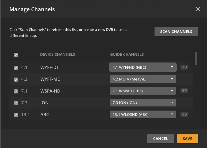

During the tuner setup process, you’re given the opportunity to map channels from your guide data to the OTA channels:
The list on the left shows the channels detected by the tuner and the list on the right has the channels from the guide you picked. If you enable a channel in the left-hand list, you can select what channel’s guide data is used for it in the right-hand list. So, if you set your Prime up first, and choose your cable provider’s guide data when you configure it, you’ll see those channels list as options when you set up your OTA tuner after. Assuming your cable provider carries most/all of your locals, you’ll be able to map its guide data.
As an example, assume your local, OTA NBC affiliate is on channel 4.1, and that your cable provider carries it, but on channel 204. When it’s time to configure the OTA tuner in Plex, you’d enable channel 4.1 on the left, but then select channel 204 as the guide channel on the right.
