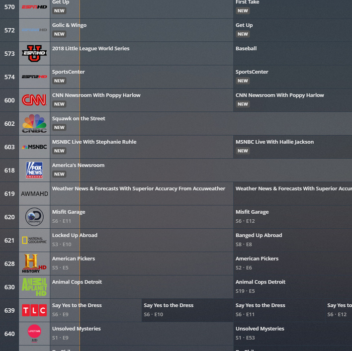

This working great on Plex Instead of OTA when I added my Quatro I selected cable and it mapped the channels correctly it even records.
Do you have a subscription? I can’t get the demo channels to show up on Plex.
Try selecting cable instead of antenna and then rescan.

you need to pay for the sub…then associate the sub to your hdhomerun
Then you need to reboot your hdhomerun - for me this got it to show up the channels as real and not demo - i use this script
“c:\Program Files\Silicondust\HDHomeRun\hdhomerun_config.exe” 10324a85 set /sys/restart self
Relace the hdhomerun name with yours
I had one of my hdhomeruns revert back to demo so there is some kinks still

Try this Video … The only channels I had to map were the OTA.
The problem I seem to have is plex wont find those extra channels. The HDHR app plays them and the device shows them. Plex just wont show them. I’ll play around more with that knowledge.
I have the HDTC-2US , maybe my hardware is too old.
It has to be a connect or quatro.
It 100% works…but will be a hot mess until plex adds custom support for this product as the ordering is all over the place - by default also it found the non hd versions of the channels and i had to hand move all of them to hd
Recording also seems to work fine…they come in as if they are over the air channels with the same .ts stream and subtitle style
