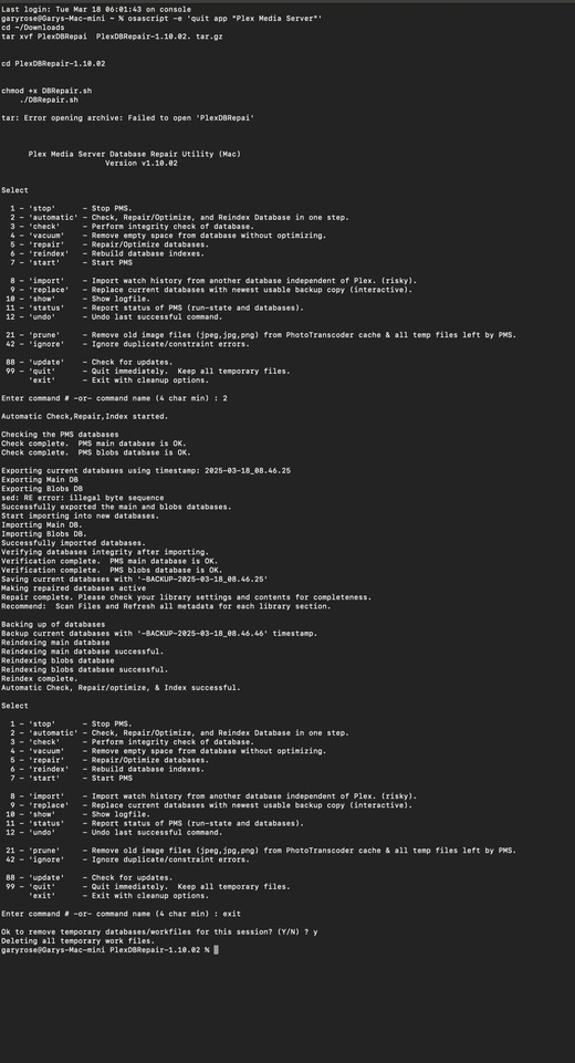

Hi, after running DBRepair 1.10.0`2, I have noticed the following.
MacOS
Does this indicate any issue I need worry about, it appears on every repair in terminal?
sed: RE error: illegal byte sequence
Cheers
@SE56
Yes, that’s significant. What were you doing to cause it ?
I do not know, Is there a common way it can happen. It seems it is not causing a issue that I can detect.
It shows up in Terminal after using PlexDBRepair.
when you ran it, what was it doing / which commands did you issue ?
“2” and finished with “exit”

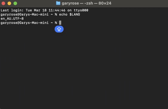

@ChuckPa
Have you modified your shell environment? What’s your $LANG?
%echo $LANG

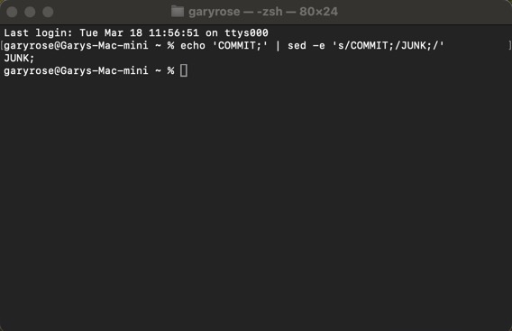

@Volts
as requested
I requested this please:
echo 'COMMIT;' | sed -e 's/COMMIT;/JUNK;/'
See if this is the error.
If not then I’m going to need some serious DEBUG help with MacOS because there’s some stupid new bug in otherwise rock solid code.
Could this be possibly be the following, introduced recently.
I have it disabled
OOOOOOH, this is going to get ugly.
no error on that regular expression (the only one used in “Auto” processing.
