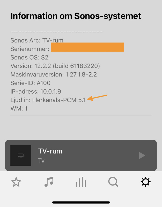

It’s okay
Yes, if the movie has Atmos (through DD+) The the will show Dolby Atmos on the tv-screen and in the Sonos app on my iPhone.
Now, it says Multichannel PCM 5.1

Can you playback a video with Dolby atmos, let it play for 30 seconds, then grab the logs from the Apple TV. Apple TV Logs | Plex Support
