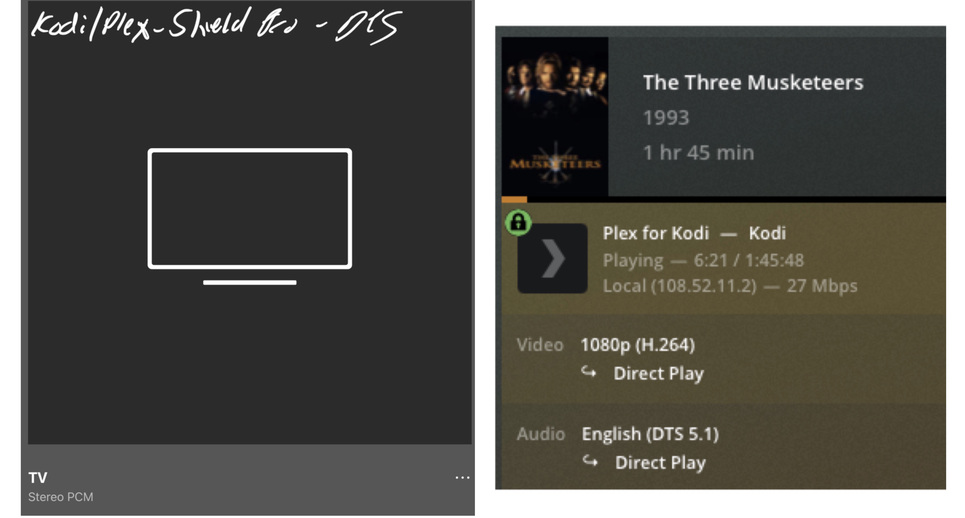

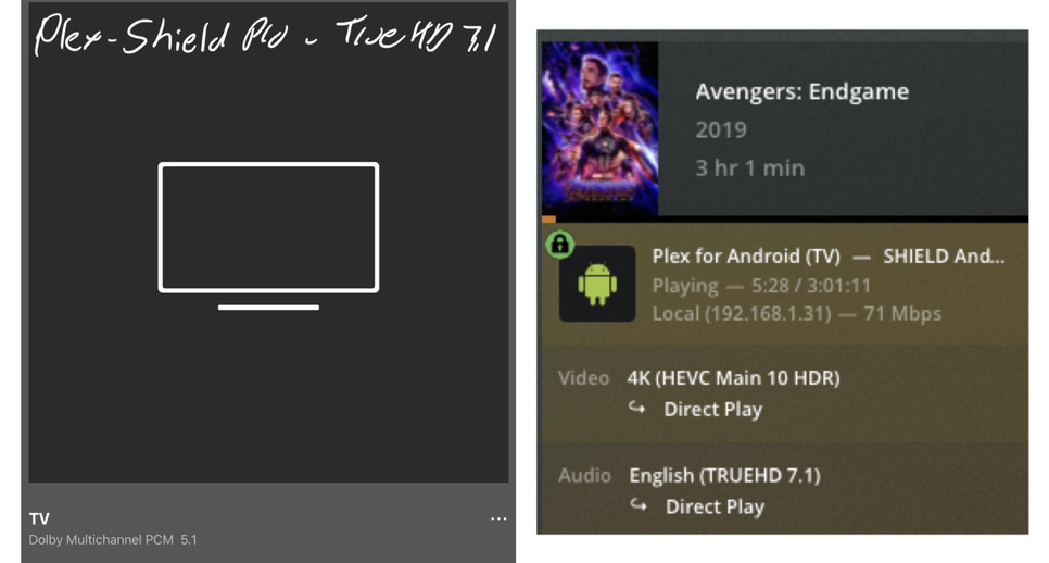

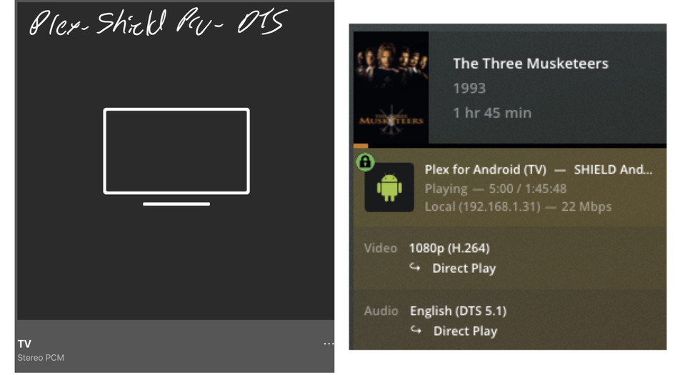

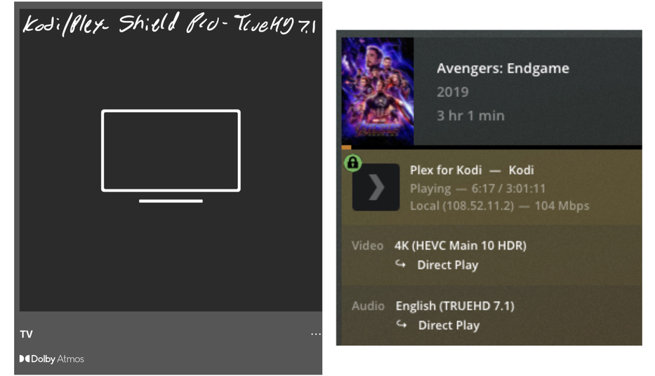

I recently started having picture tinting issues with my Plex on Roku and decided to try AppleTV and Nvidia Shield Pro devices out. The Roku did a good job with the Atmos audio and converted DTS into a nice surround 5.1 so that I did not miss the DTS support on the Sonos Arc. I did some testing using Plex, Infuse and Kodi/Plex and came up with some odd results. I was trying to get feedback as to how others have solved the audio limitations of PLex with Sonos Arc. See included images. I am running Plex Server on a Synology DS1520+. The streaming devices are connected to a Samsung Q90T TV using eARC and a high-end 8K HDMI cable to the Sonos Arc.
FYI:
Those are the settings I have inside the Shield. I cannot hear almost anything from the rear speakers using that config and as you can see in the images, the Sonos sees it as “Stereo PCM”. I don’t hear a big difference in the audio between the actual TrueHD using the Shield Pro and the Plex/Infuse version of Atmos on the AppleTV so I am leaning toward keeping that since the DTS experience is more robust.

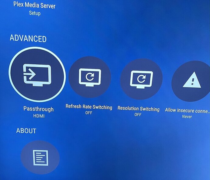

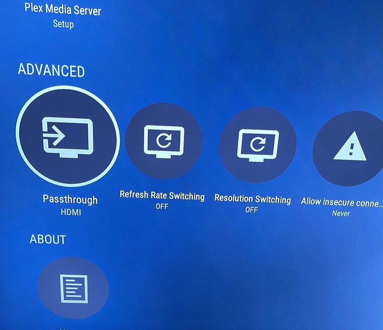

In the Plex app on the Shield, do you have Passthrough = HDMI?

Disabling dts & dts-HD audio did not always work. On earlier Nvidia SW releases it would cause other audio formats to transcode. I don’t know exactly when it started working. I noticed it with the last update.

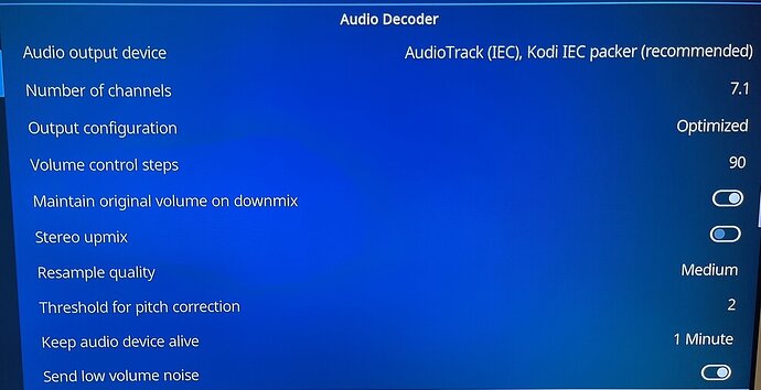

All software is 100% up to date. Settings shown (including Kodi with Plex add-in) below…
