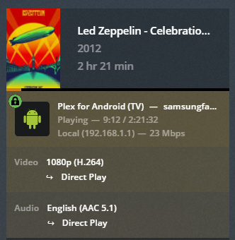

Here is an example… the “android TV” device is the fire stick… the .140 device is my “plugged in” desktop PC.

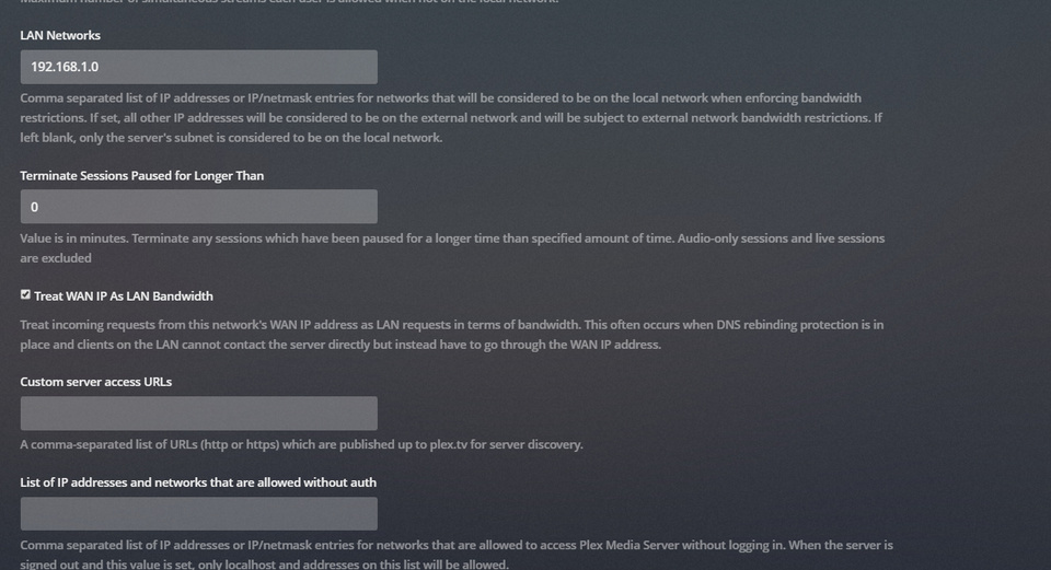

The treat WAP IP boxed was checked. This is what it currently looks like… is the “LAN networks” setting correct?
No. If you want to define your whole local network, you need to notate it this way:
192.168.1.0/24
I will try that IP setting.

The LAN Networks setting resolved my plex problem. Still got a weird network problem to work thru but that same device now shows as “local”
