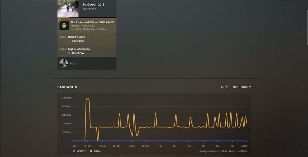

The worse offender is Bravia. While Nvidia will start playing after I wait long enough, Apple TV stutters but the Bravia refuses to play the file and freezes on the first frame.
Before someone tells me its a wifi/network issue. Emby Server running on the same QNAP NAS and the emby client running on all the above mentioned devices have no issues direct playing the file.

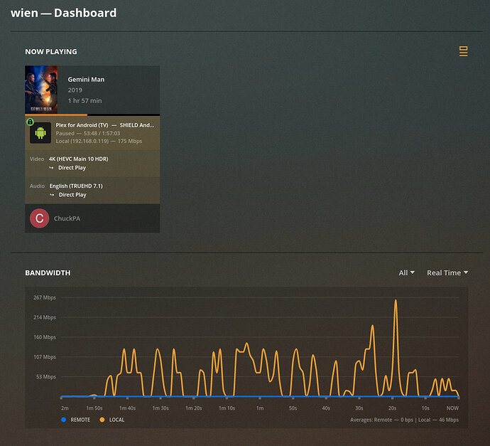

I see a weird behaviour with Plex bandwidth consumption and have provided a screenshot below.. is this normal? It consistently falls back to 63 Mbps and then just does this see saw…

  4. The bandwidth chart you’re seeing is how the network is actually being utilized.
    a. The initial full speed & sustained burst to load the player buffer and start playback
    b. The server keeping the buffer full although there is a period of low data demand
    c. Followed by those fluctuations (both up and down) inclusive of that string of spikes which probably coincides with fast action or rapid scene changes.
CGI imagery very commonly generates a lot of these because the edges are crisp and data rate demanding for those moments.
In a nutshell, Is this normal? I cannot be 100% definitive without seeing the XML / media info but it seems to be a 4K image and not the least bit surprising to me. When I am playing HEVC 2160p, I see bandwidth like this all the time.

  7. In the bandwidth chart you posted, that initial spike seems to be consistent with 100 Mbps content. (100 Mbps ethernet is actually about 134 Mbit raw – which is what the graph shows)

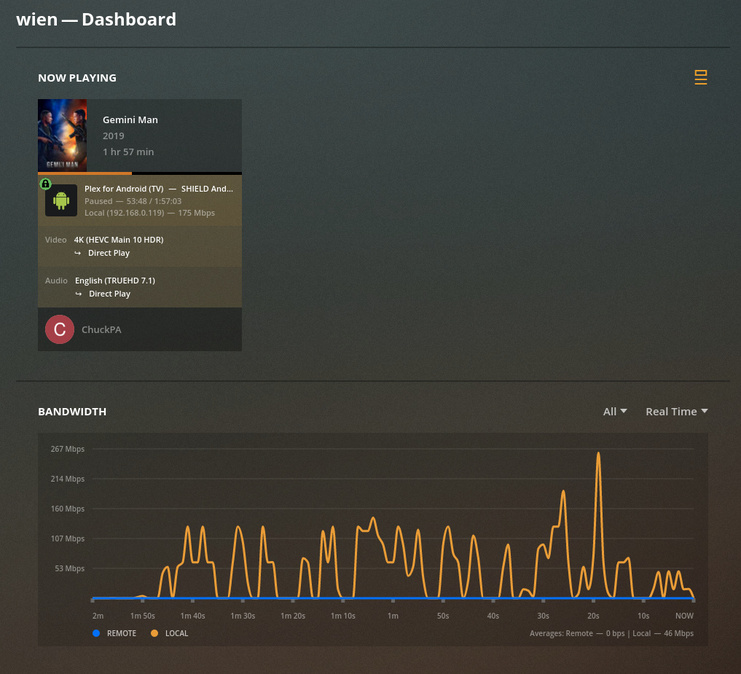

Here is what my shield looks like playingthat file
EDIT: Replaced bandwidth screenshot with that of Gemini Man (referenced above)
