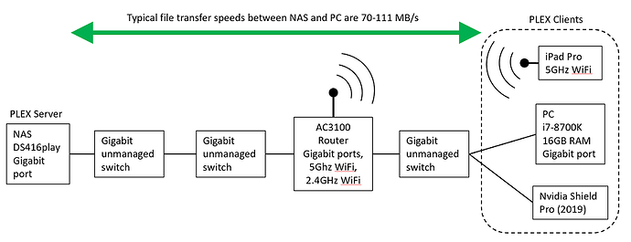

The Shields and my PC are plugged into an LG 65C9 OLED via HDMI and the tv is connected to a Sony STR-DH790 receiver using eARC.
Here is a picture of my network setup:
I typically get around 110MB/s file transfers between my NAS and my PC on the other side of the network:

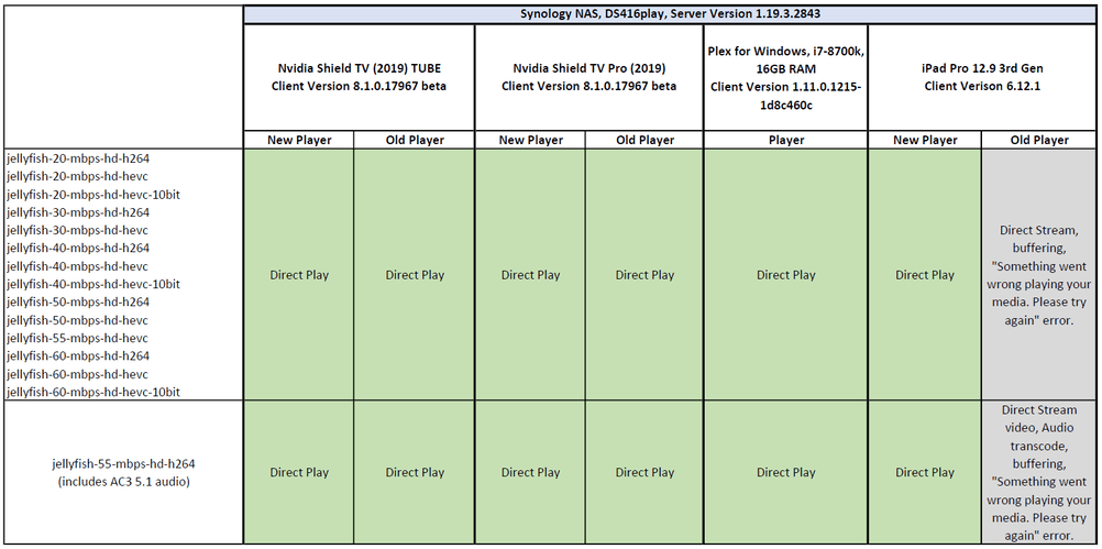

So I put the various Jellyfish files on my NAS and tried to play them on my clients and this is the result:
20-60Mbps
140Mbps and up:

  1. Is the client hardware/software combination the limiting factor in playing back these particular files? My PC using Plex for Windows had the most success. Is that because it has the processing capacity to deal with 300Mbps files?
  2. Is it safe to assume that my NAS and network connections are fast enough to feed my clients as much data as they can handle? I realize a simple Windows file transfer and Plex handing data from the server to the client are not exactly the same thing, but the file transfer speed would suggest my network is good up to the 880Mbps range.
  3. How does Plex decide that these simple video only files need to be transcoded? It looks like the Nvidia Shields are trying to convert the 200Mbps files (based on the “Not enough CPU…” error). Does the client know how much it can handle and report that to the Server?

Please include lower bitrate files as well as if you have hw transcoding features enabled or not. I have been using these test files for a long time with plex and frankly found playback issues on much lower bitrates that you describe here, problems I have never been able to resolve. 40mbps HEVC was an issue even.
@ChuckPa I added the 20-60Mbps results to the first post so people won’t have to dig through the thread for them.
@mervincm All the 20-60Mbps jellyfish files direct played on all my clients (except the old player on the iPad, which I’m not all that interested in). I have pretty much disabled the transcoding on my NAS server because I primarily use it at home and would rather direct play my files. Also, my NAS isn’t very good at transcoding my files. I choose whatever options that the clients have to play maximum quality and to passthrough the audio to my receiver.

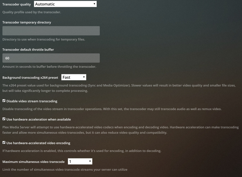

Here are my server transcoder settings if you are interested:
