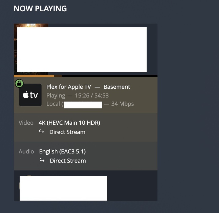

Here is what the dashboard says - video is stuttering… doesn’t say much to me? See next message for screenshot of Direct Stream.
Screen Shot 2021-11-17 at 2.15.28 PM
… and here is what I get with direct streaming. Video is great with no stuttering. Notice how the MBPS is different in direct play vs stream? Any significance?
I will also note that if I turn off the enhanced player, direct play works fine … but the colors are noticably darker… almost too dim to watch.
No real significance in regards to the Mbps. The Apple TV is probably just struggling to convert the content. you’re good to go with the direct stream from what I can see. #enjoy. What interests me is are you able to visually see any differences? HDR has been an issue on and off depending on content. not sure if Plex has fixed this issue and with EAC3, you won’t have any issues but I would love to see what happens when you try to play something with Atmos audio.
