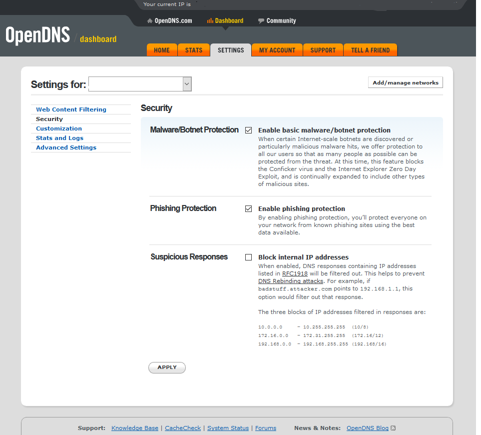

This is how I have my OpenDNS account set up to allow RFC1918 IPs to be returned and it seems to work for me:
I have the same settings as well. Mine does not work unfortunatly. Thank you for the responses.
Do you have the OpenDNS servers set on the clients or just on the router? IE, are the clients set to use the router as their DNS?
DNS Servers are set on router only.
