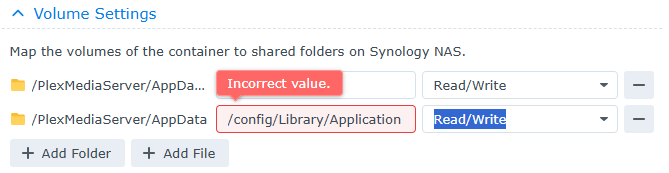

My first problem starts at the container creation segment where i’m supposed to map /PlexMediaServer/AppData` → /config/Library/Application Support. I’m using synology container manager and the mapping interface doesn’t seem to like spaces and I can’t enter ‘Application Support’.

Here you see me typing in the path.
Can you not do this?

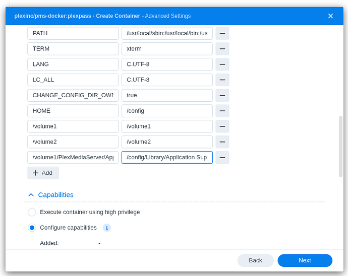

From your original screenshot in the guide it looks like you input in the volume settings. The screenshot in your response here looks to me like the variables section. I don’t know if i may be misinterpreting this.
This is what I get in the volume section.

/PlexMediaServer/AppData/Plex Media Server -> /config/Library/Application Support/Plex Media Server
Once i put a space in that right hand box, it turns red and says incorrect value. I tried to enclose with quotation marks hoping that would assist but that didn’t help either.
For testing, if i remove the spaces or replace them with a - the error goes away.

That’s a Container Manager bug.
Linux allows spaces in names. Container manager is not allowing it.

The use of space character is a known issue with volume mapping in Container Manager. As a workaround, create the container with erroneous mappings to bypass the limitation then export and edit the json file to correct the values, delete the container and import using the corrected file. If anyone would like to see the response in full, let me know, I would be happy to post.
Using this information I was able to get the container running which now looks like this.
This leads me to my second issue where lack of experience has the better of me. How do I add the --device /dev/dri:/dev/dri to enable hardware transcoding?
