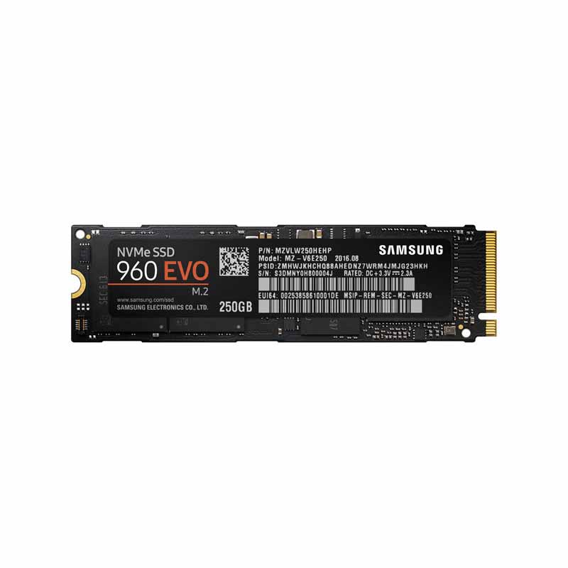

250gb Samsung 960 Evo for 110$ + Tax @ Frys is a good deal, too…
(I’m going to return the intel 128gb unopened - this is a pretty huge perf upgrade for 60$, and it doubles the space.)
