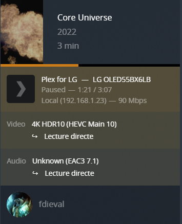

I uploaded a few trailers from thedigitaltheater to my server, then tried to play them on my TV and the result is the same for all of them (chameleon, core universe, escape, leviathan and pufferfish).
Plex display 4 audio tracks as shown below:
plex_audio_tracks
If I select TRUEHD 7.1, Plex transcode as expected:
plex_transcode
If I select EAC3 7.1, Plex direct play as expected:
plex_direct

There is something strange happening with the LG app and picking the desired audio track.
With Chameleon and Core Universe if I pick the EAC3 + Atmos track I also hear the “wrong track” message.
If I pick the fourth / last audio track, I hear the EAC3 + Atmos audio and my receiver displays “Atmos.”
It seems limited to the Plex LG app. Plex Web, Plex for Windows, Plex for Android pick/play the audio tracks correctly.

I tried to play each track of “Core Universe” on Plex TV app and here’s the result:
  • TRUEHD 7.1 : sound is transcoded but plays correctly
  • AC3 5.1 : no sound at all
  • EAC3 7.1 : “wrong track” message is played
Maybe we can find pure EAC3 Atmos tracks?
