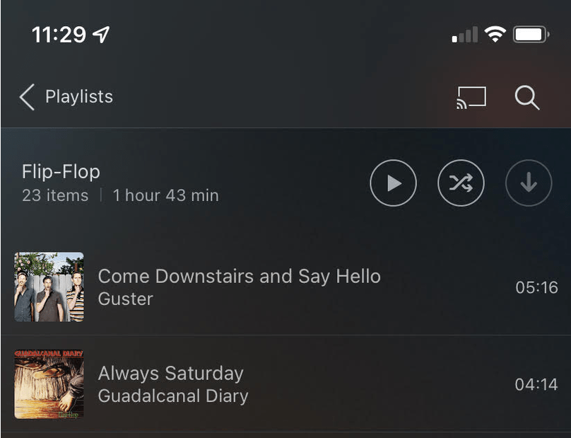

Download button greyed out in playlist?
Why is the download button greyed out in the playlist window?
iOS, iPhone 11, SV 15.6.1

Hmm. Not sure. From the previous screen, what happens if you long press on the playlist? Do you get the option to download there?
Sorry for the delay, I appreciate your response. I was away for the weekend.
This is the previous screen and long press:
The delete Download option deletes the playlist I believe. Plex has no downloads when I go looking for them.
Hmm. The app thinks you’ve already downloaded that playlist. If it hasn’t, it could be reporting that incorrectly due to a failure in the download. Go ahead and use the “delete download” option. That will not affect the actual playlist. Give the app a moment to update and the “Download” option should be back.
