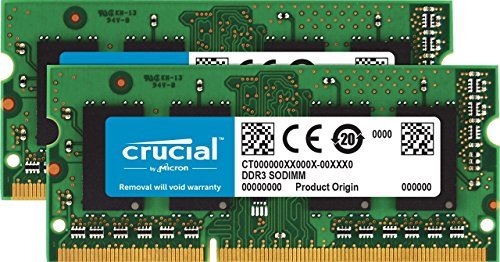

What kit did you install?
It’s this one:
To closely match the specs of the Syno kits.
Thanks.
Now it is clear.
16 GB of DDR3,
8 GB of LPDDR4
