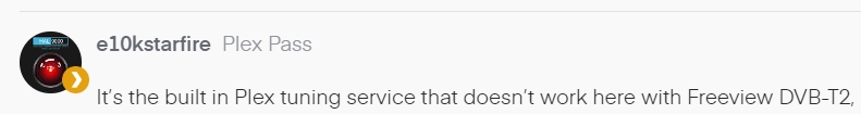

It’s the built in Plex tuning service that doesn’t work here with Freeview DVB-T2, using network based tuners Plex is not using it’s internal tuning service and does not have an issue.
