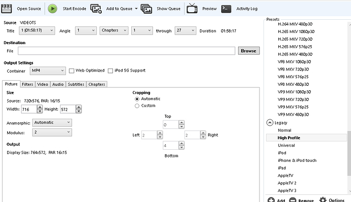

Hi. I am trying to convert a pal dvd. And You mentioned before about 1024 being the magic display number for 16:9 tvs. But I cannot figure out how to achieve this in handbrake since they took away custom…how do i input the disply to be 1024? Any tips appreciated…thanks
I assume if the base/original has anamorphic flag (as my test files did) when using Auto they’ll just work (as my test files did).
I can see you are having some difficulty in that region.
I also assume since the base/original is 720x576, Handbrake will magically know that the display size will end up being 1024 (or something close) if you use Auto. Looks like you’re going to have to use a custom crop, get those numbers back up to original and also try to set an anamorphic flag properly before you bring it in to handbrake… or something.
You may have to back up a version.
This bit is pretty new to me - and it’s kinda clear Handbrake hasn’t exactly figured it out - if asshat moves like this are in play.
You’ll also want to tic the Web Optimized box for MP4/M4V
Ok… disregard some of that… we’ll work out which bits later… lol
Start with the Legacy - High Profile profile…
Drag your file onto Handbrake… you should see the 576 bit is greyed out, but now chose Automatic from the Anamorphic Dropdown. 576 should now snap in and you should get new info in the Display Size area - like I did:
What’d you get?
Right now I’m creating a DVD Profile 'cause I’ll want my files to be MKV, AC3 Audio, etc - and apparently it really depends where you start BEFORE a file lands in Handbrake.
Still kinda ignernt, if you ask me, but it is what it is.

THANKS JUICE! But I did what you said..high profile legacy and I still get 716 * 572..pic attached..nothing is greyed out…Pal sourced dvd
Wait…I chose LOOSE instead of automatic and i got this…is this good?
I’m looking to just play it on my 4k 65" tv…also should I go with x265? my sony tv decodes it ok…
There is no (good) reason to use 265 - and if you do you are totally on your own.
Something isn’t right with your source. It must not have an anamorphic flag (guessing). I’d like to see a mediainfo report of it.

I’m guessing, but this must tell Handbrake how to react while in Automatic Mode because for me it results in a correct output display size of 849x480. Ideally for you it would be 1024x576, but, for some reason, that’s not happening on your end.
This whole area right here is a bit screwy. You may have to back up a version, or use Loose, or something, and force a 1024x576 with no anamorphic setting (which would really suck).

The important bits are probably:
Width : 720 pixels
Height : 480 pixels
Display aspect ratio : 16:9
Original display aspect ratio : 16:9
Thanks again. I’m using mediainfo but not to skilled at parsing the info. Here’'s the main page…
ps…I don’t have the actually dvd - it’s in a VIDEO_TS folder
Yea, I’m not sure what 4:3 is going to be @ 576p. I could figure it out, but am crosseyed right now after 6 hours on Autocad. Maybe later…
4:3 for 480p is 640x480. I have some of those and will run them in later and see if Automatic does the right thing for me.
