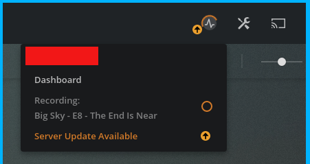

Big Sky S01E07 did not record on Feb 02, and i’m just seeing it now.
Big Sky S01E08 also did not record on Feb 09 (last night).
what’s extra weird is that the server seems to be stuck thinking it is still recording:
can anyone give some advice how to investigate this?

The logs do confirm what you are seeing in the status - that recording gets to 100%, but then it doesn’t proceed to the next step:
Feb 09, 2021 23:02:00.878 [0x7fb57ffff700] DEBUG - [Grabber/585a6405e9a8a672e453c7bf1de1218295f1bacd] Activity: updated activity 0dea69e7-c79a-4209-ae0b-dba811b993b9 - completed 100.0% - Recording
Looking in my logs at a successful recording, after it hits 100% Plex should then immediately proceed with processing the file from the .grab location, but yours doesn’t. While I don’t see associated errors in your logs, there are thousands of http request/responses like this in your logs that don’t appear in mine:

I have a network tuner, not usb, and the http 200 response is an “ok” response, but still - this looks odd. Port 32600 is what the Plex Tuner Service listens on (e.g. it manages communications with your TV tuner.) I’d suggest starting with looking at your Plex Tuner Service log files to see if there is anything out of order.
yea, i saw all of those requests. i assume it is the server getting a recording status from the tuner because the server thinks it is still recording something.
It also appeared that when this one (failed) recording was going on, that the server thought there were now TWO active recordings…
