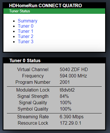

Start by using the regular TV app from Silicon Dust and keep an eye on the signal strength and Signal quality indicators.
You can see these also when you open the internal web page on the HDhomerun device (“Tuner status”), while Plex is playing live tv or is doing a recording.

My status shows 100% quality and 100% signal.
DVD Tuner 0 Status
Then I have unfortunately no other idea than interference by other electric devices and/or damaged cables (shielding in particular).
