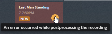

I am running on a CentOS 7 VM and the post processing that removes commercials has been failing for the past 4 months or so. It was working just fine for many months prior. This is my second time posting and hopefully I will actually get some help this time. I have tried loading Plex on a fresh VM and get the exact same problem.
I don’t completely understand how the removal works, but it appears that there is a text file that is supposed to get moved from the temp recording directory to the permanent storage location. The .ts file gets moved without issue, but the move of the .txt file fails.

Yes commercial removal is turned on. I get this error on everything that has it turned on and commercials are not removed.
2019-03-16%2005_37_02-Plex%20Media%20Player
