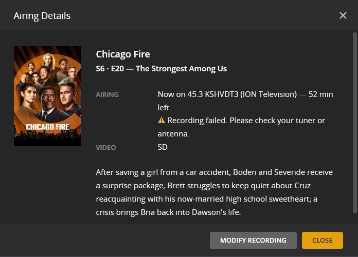

Good afternoon,
Having an issue on one show on one channel. Chicago Fire on ION TV. It records some episodes and others it gives an error “Recording failed. Please check your tuner or antenna.” All the other channels record just fine. Other shows on this channel record just fine. Can someone look at the logs attached and see if they can identify the issue?
Thanks,
Larry
Plex Media Server Logs_2022-07-12_14-03-04.zip (5.9 MB)
