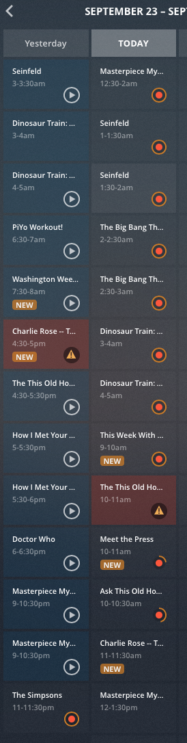

Here are more logs that I pulled down while it is in the middle of recording a show. So as you can see from the screenshot below, the DVR Not Recording issue started with the 9/23 11pm Simpsons recording and persisted with and through at least the 9/24 9am This Week with George Stephanopolos.
I also pasted a screenshot on the TV Recording .grab folder and attached the contents. As you can tell the 11pm Simpsons recording very early in the recording process as it only has 5 MB.
