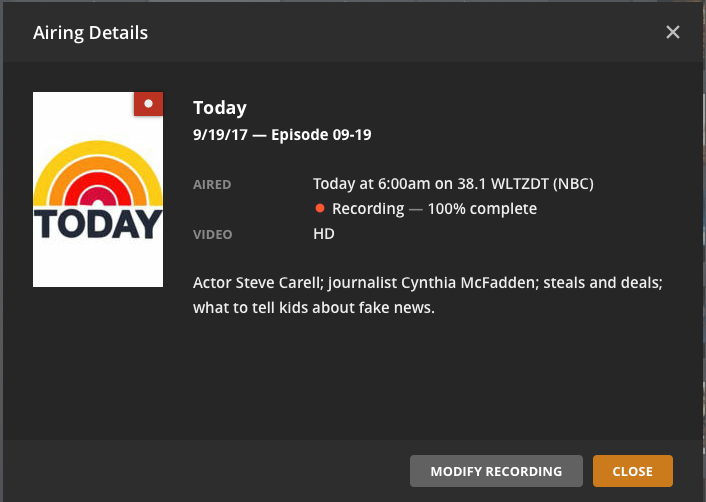

Recording showing in progress and 100% complete.
I have rebuilt my Mac mini (late 2014) with a new build of Mac OS 10.12. Fresh install of Plex 1.9.
I set a recording for the Today show at 6:00am central time. The recording shows that it is 100% complete but still in progress.
After the recording was supposed to end I used the HDHomeRun app and made sure I could watch NBC there.
In the “grab” folder I see a *.ts file for the show, but it is only 379.4MB (Small for a 1 hour HD show). I also notice there are 2 active transcode sessions, though there is nothing that should be recording now and no other activity on the system.
Once I killed the active transcode sessions there was a flurry of activity and then the “Today Show” showed up under “Recently Added Television”. When I looked at the details of the show, it is only 50 minutes long.
I do not have any post processing scripts at this time.
Looking at the file now in the TV folder on disk, it shows a date modified of “Today, 6:51 AM”. If the recording had completed successfully I would have expected this to be 7:00 AM.
When I try to play the file it plays for roughly 3 minutes and 10 seconds and then the video freezes while the audio continues to play for some time, but the video never starts playing again. While I haven’t listened to the rest of the show, I assume it will end about the 50 minute mark. If I try to fast forward through the show, the Plex Media Player closes.
I have tried this on IOS, TVOS, Plex Web and the show stops at the same 3:10 second mark but then gives me an error of “An error occurred trying to play “episode 90-19”. shaka3016 (Media)”.
I’ve attached the logs from this morning. Please let me know if there is anything else I can provide or if you would like me to reproduce this issue.

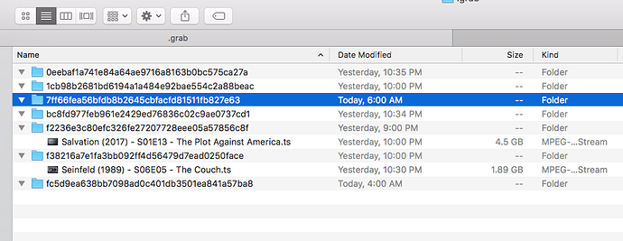

You can see in the screenshot that Flags of our Fathers recorded fine from 2:30-5:00 yesterday. Then from 9-10 Salvation was supposed to record but is stuck at 100% AND still Recording.
From there the rest of the recordings are hung at the Recording - 100% complete.
If I look in the .grab folder, Salvation is still in there with a 4.5GB file. Seinfeld is in there as well with a 1.89GB file, but there is nothing for BigBang Theory which started at the same time as Seinfeld, 10:00pm.
There are no other files in the grab folder.
There are 5 transcoding sessions active but all of the shows are complete.
I do notice there are 3 Plex Transcoder processes still running and have been running for various lengths.
Logs are attached. Please let me know if there is something else I can provide to help with this issue.

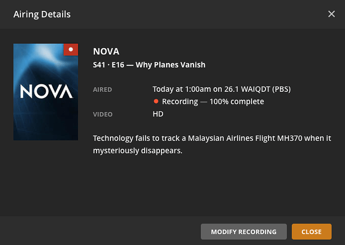

Well, I had been working fine for several days with only the Extend added to the DVR. However, last night / this morning I have NOVA get to the same state. Stuck at 100% and 2 transcoding sessions going, when there is no activity.
Now, the interesting thing about this is the next recording worked.
In the screen shot below you see that NOVA is still hung, but the “Today” show worked. (Which means my wife is not made at me).
So this is progress of some sort right? Right? No really, right?
Here’s hoping that 1.9.3 comes out soon and fixes the problems with the Tuners.
