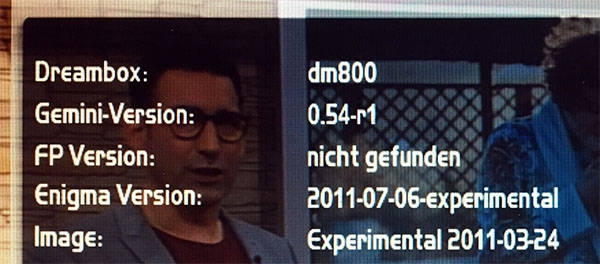

@andyblac1974:
Thanks. Im using the following Image:
BR
Peter
@furrore said:
In my opinion is a Dreambox DM800 as a Singel Tuner Box with very little memory badly suitable as a streaming source.
An exact specification of the DM800 model would be helpful
DM800HD PVR (Generation 1)
DM800HD se (Generation 2)
DM800HD se V2 ((Generation 3)
This also makes it possible to make an exact statement of the available memory
Also the image version Newnigma2 Vx.x (or Gemini Vx.x @Peter91101)
Frankly I don’t think it is a question of memory. I had the exact same issue with my DM 900 not booting anymore, which should be more than powerful enough. I guess the problem is that Dreambox images have a different implementation of the streaming server, which is different from what is found in the open* images, for which this plugin was produced.
At least this should be the case for my DM900, not sure about you @Peter91101 since you run a pretty old image version.
