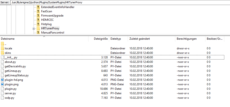

Looks like it doesnt work on the newest VTI Image (v13) ? Atleast when I try to copy the folder to: /usr/lib/enigma2/python/Plugins/Extensions
It wont show up in my extensions menu. Or am I too stupid?
need to go into SystemPlugins aka /usr/lib/enigma2/python/Plugins/SystemPlugins

@andyblac1974 said:
Sorry, typo. It is in this folder and won’t show up.
@Nigthmare said:
@andyblac1974 said:
ok then i’ll need an enigma2 log, to see why it not running.

can you supply log file from /tmp and a screen shot of your setup from plugin please.
Plugin info:
And log from /tmp
Plugin info:
And log from /tmp
unzip upload these, reboot, get me new log from tmp. thanks
