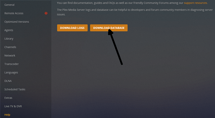

Do want a copy of the databases from each version, before I update to the next version?
I won’t need the databases.
If Tim needs them (bug tracing), he’ll ask. For now, let’s see if we can find out where the compromised files are originating.
OK, I’ll capture (and hold on to) the databases before each update and at the end so I won’t have to repeat the exercise.

15:44 Downloaded v1.11.1.4760 databases
15:44 Downloaded logs

Please hang on to the databases in case @timwoj wants to see them.
