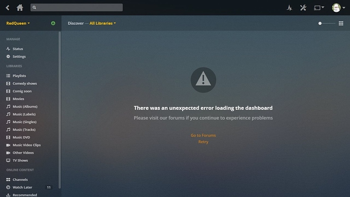

I’m running Plex Media Server on a Synology DS412+. It has been running great up to version 1.7.6. When I update my Plex Media server from version 1.7.6 to 1.8.0 (or later) I get several errors, that occur as well on Plex Web as any app (Windows, Android, …)
  • First, when I open Plex, the dashboard won’t load and shows the error: “There was an unexpected error loading the dashboard”.
  • Second, when I select a library (for example movies), the entire list is showed. However, clicking a movie to see the details gives me a simular error: “There was an unexpected error loading this item.”
When I uninstalled version 1.8.0 and re-installed version 1.7.6, I got everything running perfectly again. In the meantime, version 1.8.1 has arrived, but I have the exact same error there.
