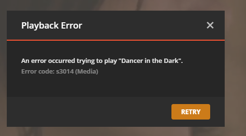

Has anybody else been getting this error message? Have had this now and it stops playback and just buffers. My internet connection fine, and the file is a standard mp4 and works fine as a basic file when played.
Any guidance much appreciated.

An error occurred trying to play “Episode 2”.
Error code: s3015 (Media)
