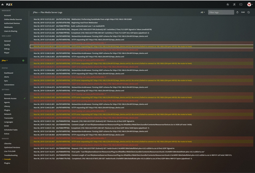

Error requesting GET http://192.168.0.254:49152/wps_device.xml

TimeNov 04, 2019 12:37:46.911
LevelWarning
Thread0x7fd7d6ffd700
MessageHTTP error requesting GET http://192.168.0.254:49152/wps_device.xml (0, No error) (Failed to connect to 192.168.0.254 port 49152: No route to host)

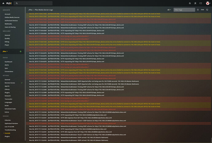

So I guess the big question would be, is the console interface in PMS just a snap shot of my entire network or is it just what plex is doing? If it is just what plex is doing then why is plex pinging all my devices? This is kinda crazy. I mean talk about wasting resources. Something is ping my .254 address all the time which is driving me crazy. I know it is just my OCD kicking in but, it does not need to happen, as I see no upside to have it constantly pinging this address. Once maybe but not every few seconds. The console shows that Plex is even pinging all my amazon devices, again unless console is just a overview of my entire network traffic and not just what plex is doing.
I’ll add that I am not the only PMS user that this address is being pinged. ( ā€œSSDP: Error parsing device schema for http://192.168.0.254:49152/wps_device.xmlā€ this is from another thread where the same no solution follow up questions are being asked, the PMS user is not even on that network range.), Which leads me to believe that the console is a snap shot of what PMS is doing. So some where in the code PMS has been told to ping this address. Unless if PMS has some how gained consciousness and is doing it all on its own with no programmer input.
