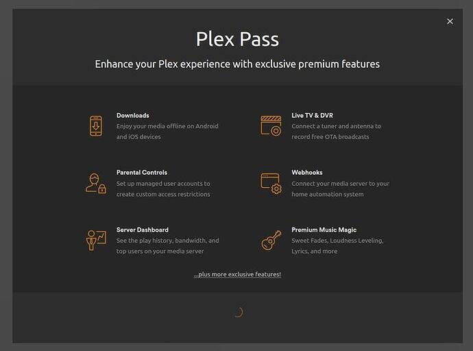

Got you some logs which will hopefully help in finding this problem. This is what I done …
ubuntu 22.04 64bit - chrome empty browser cache using local device IP for setup:
  1. clean fresh install of plexmediaserver_1.31.2.6739-a87e876bd_amd64.deb – failed initial setup – logs within folder Logs-plexmediaserver_1.31.2.6739-FAILED of zip.
  2. clean fresh install of plexmediaserver_1.31.1.6733-bc0674160_amd64.deb – success – logs within folder Logs-plexmediaserver_1.31.1.6733-SUCCESS of zip.
Plex was removed and purged between tests sudo apt remove --purge plexmediaserver.
One other thing I noticed doing these tests back to back that was using the bad build 1.31.2.6739 this screen never appeared. Maybe the endpoint which that build is looking for has changed blocking the rest of the setup …
Anyhow, IMO 1.31.2.6739 should be pulled from the beta channel – there are now so many threads with this ā€œA Problem has been detected ā€¦ā€ error.
